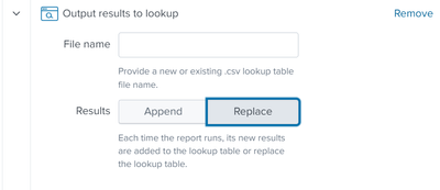

Hello Simon,
Thank you for providing additional context about your requirement. To make sure that you use the throttling part by saving the search as an alert, you can output the results of the search to a lookup using the alert action for sending data to a lookup and choosing the append or override results as per your convenience and then create another alert to use the data in the lookup and send it to an index using collect command as there is no alert action to send the data to an index by default in Splunk.

Hello Simon,

simon_b
Hi Shiv,
thanks again for the answer.
I actually was aware of that solution, but don't find it very elegant or efficient. Facing that there is no better solution, I think I'll do it like you explained.
