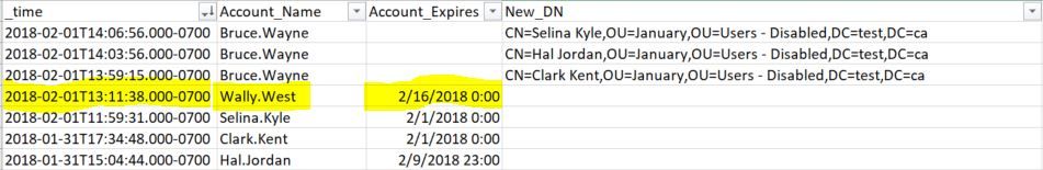

We have a search that will show both an Active Directory account that has been set to expire and it will also show if the account was moved to the correct Organizational Unit.
EventCode=4738 Account_Expires!="-" | eval  Account_Name=mvindex(Account_Name, -1) | table _time, Account_Name, Account_Expires| append [|search  EventCode=5139 [|search EventCode=4738 Account_Expires!="-" | eval  Account_Name=mvindex(Account_Name, -1) |eval New_DN="CN=".replace(Account_Name,"\."," ").",OU=*,OU=Users - Disabled,DC=testdomain,DC=ca" | table New_DN] |table _time, Account_Name, New_DN, Old_DN]
We would like to create an alert that would notify us if there is no match between the two with approximately 7 days. For example, as per the image below, an alert would notify us that "Wally.West" has not been moved to the Disabled OU within 7 days.
Any help with this would be greatly appreciated.
