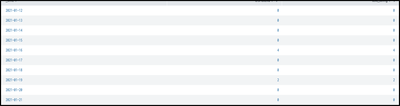

Hi @lazyturtle_,
Please try below;
| rex "ReservationConfirmRS\sreturned\serrors\sfor\sTrainId\s(?<TrainId>\d+).+\[(?<text_string>[^\]]+)"
| timechart span=1d count(TrainId) TrainId count(text_string) as text_string
If this reply helps you an upvote and "Accept as Solution" is appreciated.
lazyturtle_
hi @scelikok ,
I tried your solution but that didn't give me the desired out put, as I said in the error message the 'TrainId' and error string in the bracket could be different, some of the examples below:
- ReservationConfirmRS returned errors for TrainId 12411 and reference number null[There is a Stop sale for TrainId: 12411,  fromDate: 2021-02-12, toDate: 2021-02-22]
- ReservationConfirmRS returned errors for TrainId 12973 and reference number null[The trxn could not been confirmed. Please try again. Cause: ]'
- ReservationConfirmRS returned errors for TrainId 23765 and reference number null[[There was one error in the communication with the reservation system]
