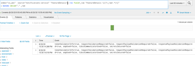

vinod0313
After trying with your suggested query i am getting below response
i am not getting the result as asked like below

Hi @vinod0313 , adding a reference screenshot with the test query with which it splitting the , by a new line in _raw events
index=_internal "," sourcetype=itsi_internal_log
| rex field=_raw mode=sed "s/,/\n/g"
