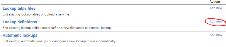

I'm adding this as an answer because I can't add a screenshot to a comment - but this is in response to your thought that you couldn't configure a lookup without file access to transforms.conf. You actually can achieve the same thing through the UI. Go to Settings > Lookups, and that will take you to this menu:
Under Add New, you'll find the settings page to configure your existing CSV as a full lookup, allowing you to use the lookup command.
