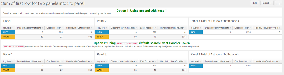

Ok, let me give two options, hopefully one of them you can use. It uses run anywhere searches based on Splunk's _internal index. You can maybe correct/change them as per what you currently have but keep on using _internal index instead.
1) Option 1 : Using append with head 1. Here Post processing may be applicable provided all three panel searches can be derived out of same base search). Please confirm if this is so, otherwise it is better to use append (or appendcols).
2) Option 2: Use progress or done search event handler to get the default $result.<fieldName>$ token to fetch field values from first row of results and assign to tokens. This is what you require for your use case.
Following is the run anywhere dashboard for attached screenshot with both options in separate rows.

PS: If this is not something you need please provide further details to assist.
niketn
Legend
