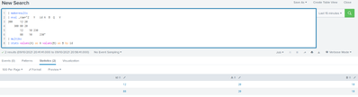

Yes, I try that but not return appropriate result, return lots of 0 for A and B while they have value.
PickleRick
Zeros? Didn't you do count(A/B) instead of values()?
indeed_2000
Motivator
Nope, i didn’t divide them.
would you please eval these four lines of log in your splunk then run your spl command?
07:59:42.213 app module: Z[200]id[12]A[20]
07:59:42.213 app module: Y[300]id[88]A[20]
07:58:21.533 app module: Q[230]id[12]B[10]
07:58:21.533 app module: V[230]id[88]B[10]
Thanks
PickleRick
Wait, wait, wait. What do you mean "eval these lines"? I can of course define fields with proper values and I know what values I'll get. But it surely won't work if you don't have proper extractions. You have proper extractions, don't you?
Anyway, here you go - I define some field values then do the stats

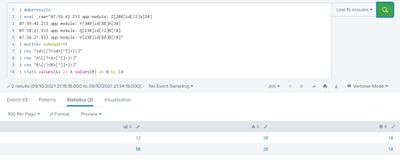

PickleRick
As I said - works for me
