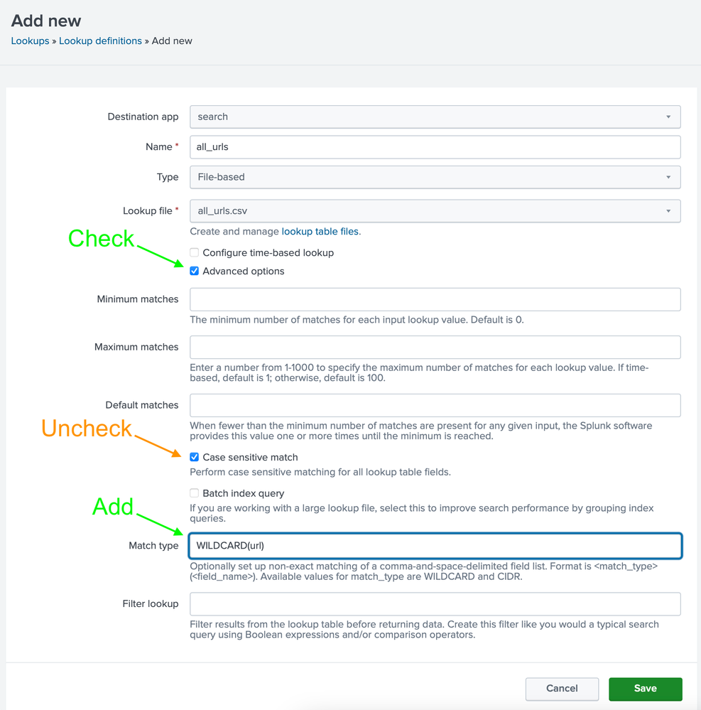

This is not correct.  As @andrew_nelson points out.  The problem is that you are trying to use inputlookup when lookup is the logical solution.  Once you define a lookup with WILDCARD(url), you do not need to add an additional field, however. (You may want to use case-insensitive match, too.)  This is how you do it in Splunk Web:
Here, I name the lookup definition without .csv.
