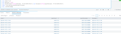

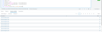

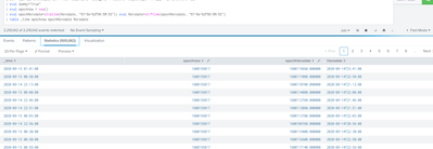

mah
Builder
Hi @gcusello ,
I run the above command :
and I run the eval command I have in my begining search :
But when I added the following command : | stats count(eval(Statut=="KO")) as KO by _time
The problem still the same :  it doesn't make a span by day anymore and the visualization goes wrong :
