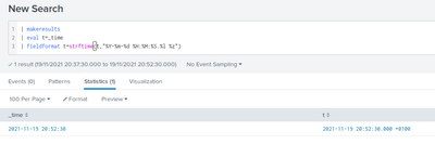

But if I started fooling around with fieldformat I started getting weird results:
| makeresults
| eval t=_time
| fieldformat t=strftime(t,"%Y-%m-%d %H:%M:%S.%l %z")
As you can see, both fields, t and _time should have the same value. And in the WebUI it does indeed seem so:
But the CSV export shows...
"_time",t
"2021-11-19T20:52:30.000+0200","2021-11-19 20:52:30.000 +0100"
So if we render the _time without the timezone information, CSV export produces the default timezone on its own anyway.
