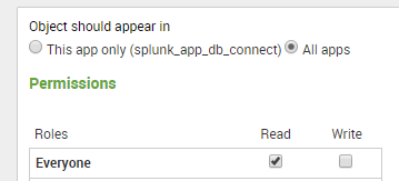

We have an issue with the access to lookup tables generated by Splunk DB Connect. The tables are shared for all apps and everyone has a read access to it.
But when we try to call for those lookups from Enterprise Security we have an error “The lookup table 'xxx.csv' does not exist or is not available.” At the same time, the lookups are perfectly usable from Search & Reportings.

Assuming you are using the dbxlookup command or dbxquery command, you need to go to the "manage app" page and select "View objects for the DB Connect app. On that page, you will see dbxlookup, dbxquery, etc. and will need to make sure Sharing is set to Global for this capability. I think that might be the issue, especially if you are using those commands.

You're right, we use dbxquery command. But it is already global.
