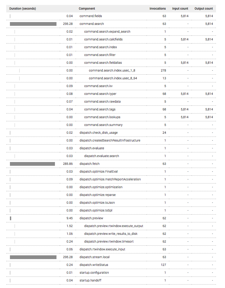

I am confused why my search doesn't finish. I have a '2 month window' applied to the time.
When I inspect the job I see: This search is still running and is approximately 100% complete.

If you specified to search with a "2 month window" that means you setup a real-time search, which is a continuously executing search.
Instead you want to run a normal historic search (using the "Relative" section of the time range picker) to which the picker would instead read "Last 2 months"

Are you selecting that "2 month window" from Real-time section of time range picker?
fraser8
Engager
Yes, i was selecting Real-time -> 2 Months Ago
