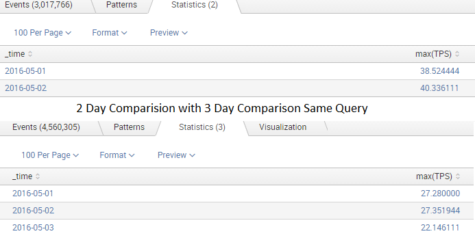

So I have a query that is
  • | timechart count | timechart per_second(count) as TPS | timechart span=1d max (TPS)
This query results in the correct data out when ran on a single day or range of 2.
However, if this query is ran for a time range that is greater than 2 days, the last "timechart span=1d max(TPS)" seems to become "timechart span=1d average(TPS)" instead.

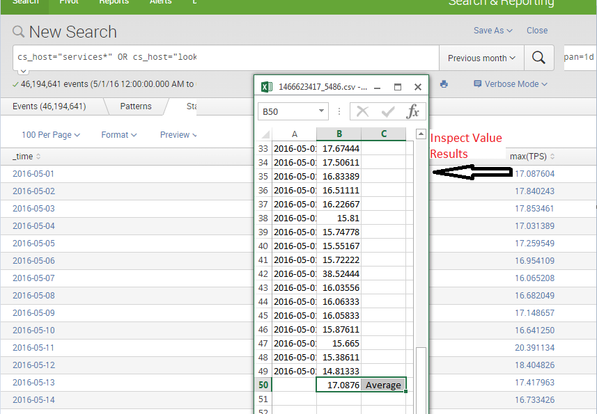

If you debug this by inspecting the evens individually the results below show that it's taking the average per day rather than the max.
I confirmed that the value represented in the month report is the average by exporting the report for an individual day in excel and simply performing the average function on that column.
