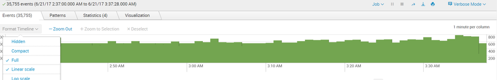

Can anyone please help me to understand why I am seeing the results in a linear format and I can not see the result properly. Here is the screenshot:

It would be very useful to have the search you are running, but perhaps this will help anyway:
You are looking at the timeline running over the past hour. The timeline isn't a "fancy view" but is instead a very plain "count" of the events that are being returned by your search, whatever it is.
So for instance, if you type into your search bar index=_internal you should see a chart like the one you took a screenshot of. It'll have parts where it goes down, parts where it goes up, or maybe it'll be more or less constant. You can click on parts of that to temporarily "filter" the list of events below to just show those.
Once you have that showing fields, though, you can click on one (well, hopefully one that would make sense to do this with) and select an aggregation that may look prettier.
For instance, run index=_internal. When you get results, on the left near the top of the interesting fields should be sourcetype (If it's not at the top, look for it alphabetically a bit farther down.). Click sourcetype and you'll see a little flyout giving you basic information about this field - the top items, how many there were in that time period and so on. Click the link at the top of that flyout that says "Top values by time" and that should take you to a prettier and more interesting view of that.

Here is the query string: index=app sourcetype=tc_jsp_ejb host="ejb" "main query string here"
Still I am seeing the results in same way if I extend the time duration to 24 hrs

So that's a custom sourcetype, I think. Which is totally fine, just means I don't have any sample data.
You are still using the timeline. The timeline is a raw count of events. If it's flat, that just means you have about the same number of events each time period. What you want to do is instead pick a metric - a value inside your data - and timeline it.

Great, that does look suspiciously flat, as opposed to the screenshot in the question which is entirely normally flat.
