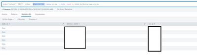

In below query I don't want to show up the result as "Up" in state_to field, I just want to see data with down state , also it not possible to use (exclude operator state_to!=Up ) because it is showing all down results which is not my aim.
Please help and suggest !
My query :
index="network" %BGP-5 *clip* | dedup src_ip | stats count by state_to,Device_name,src_ip
with exclude result: ( which I dont want)

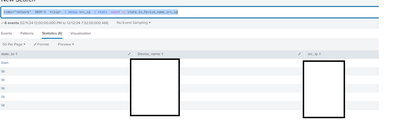

My expected result/AIM :  it will just show the result the devices which are down at the moment and dont want see the UP result
AIM :  With the help of query

Try excluding Up states at the end rather than at the beginning.
| dedup src_ip
| where state_to!="Up"

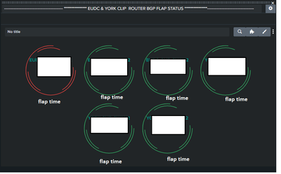

I have a Number display dashboard which represent the BGP flap details as # Device_name & #BGP peer IP , however I cannot add the timing when the BGP flap on Number display
Current Query : index="network" %BGP-5 *clip* | rex field=_raw "^(?:[^ \n]* ){4}(?P<Device_name>[^:]+)" | dedup Device_name,src_ip | stats count by Device_name,src_ip,state_to | eval primarycolor=case(state_to="Down", "#D93F3C", state_to="Up", "#31A35F") | eval secondarycolor=primarycolor
Is there something we can add to display flap time in the same number display
