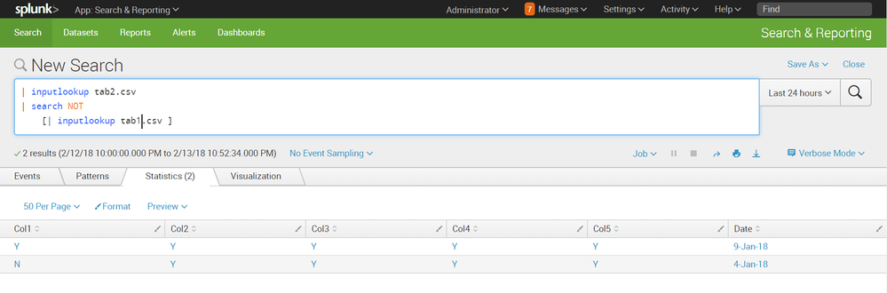

@madakkas,
copied your sample to the letter. here is a screenshot.
can you double checkalt text
adonio
Ultra Champion
@madakkas,

adonio
Ultra Champion
try this out as a base maybe we can work form there:
 | inputlookup tab2.csv
    | search NOT [| inputlookup tab1.csv ]
this will give you the entire line in which there was a change
hope it helps a little
madakkas
it just gave me the entire tab2.csv, not the differences in them .
