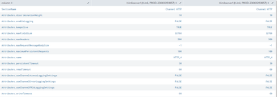

As for "traverse the Attributes field" , I want to compare the Attributes of one Application Server to another Application Server.  My results table would look something like this:
  Config Matches (y/n)? HJn6server1 (HJn6, PROD-230612151857) HJn3server1 (HJn3, PROD-230612151857)
As for my code, I am not certain of what you are asking. The dashboard I have looks as such:
The user selects an Environment/Application server pair twice, selects a Section then the dashboard shows a table (per above).

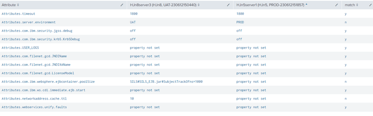

That seemed to do it. Thank you very much!  Here is the code and results:
index = websphere_cct Object IN (" HJn8server3 (HJn8, UAT-230612150440)"," HJn5server1 (HJn5, PROD-230612151857)") SectionName
| fields - _*
| fields Object Attributes.*
| eval Object = ltrim(Object, " ")
| transpose column_name=Attribute header_field=Object
| eval match = if('HJn8server3 (HJn8, UAT-230612150440)' == 'HJn5server1 (HJn5, PROD-230612151857)', "y", "n")
However, I am confused about how this code works.  Specifically, what the code "| fields - _*"   and "| eval match = if('HJn8server3 (HJn8, UAT-230612150440)' == 'HJn5server1 (HJn5, PROD-230612151857)', "y", "n")"  does?
As I understand it,  "| fields - _*"  just eliminates the fields with an underscore?
if('HJn8server3 (HJn8, UAT-230612150440)' == 'HJn5server1 (HJn5, PROD-230612151857)', "y", "n")"  I would think compares two "Object" fields.
Can you please explain?
Thank you.
yuanliu
Absolutely correct.  Because transpose is used, having extraneous fields are rather distracting.  You can also use table to list only fields that interest you.
That is because after transpose header_field=Object, the values of original Object field become column names, i.e., new field names.
