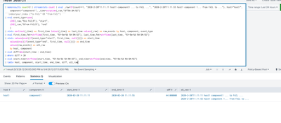

Hi @zapping575
I would generally avoid transaction where possible and try and use stats for this instead, you might find something like this works (it might need tweaking slightly) because I dont have data to test with but tried using the sample events provided:
| makeresults count=2 | streamstats count | eval _raw=IF(count==1, "2020-2-20T11:11:11 host1 component1 ... to FAIL ...", "2020-2-20T11:11:55 host1 component 1... from FAIL to ..."), host="host1", component="component1", _time=strptime(_raw,"%FT%H:%M:%S")
```index=your_index ("to FAIL" OR "from FAIL") ```
| eval event_type=case(
    LIKE(_raw,"%to FAIL%"), "start",
    LIKE(_raw,"%from FAIL%"), "end"
| stats earliest(_time) as first_time latest(_time) as last_time values(_raw) as raw_events by host, component, event_type
| eval first_time_fmt=strftime(first_time, "%Y-%m-%d %H:%M:%S"), last_time_fmt=strftime(last_time, "%Y-%m-%d %H:%M:%S")
| stats values(eval(if(event_type="start", first_time, null()))) as start_time
    values(eval(if(event_type="end", first_time, null()))) as end_time
    values(raw_events) as all_raw
    by host, component
| eval diff=abs(start_time - end_time)
| where diff > 30
| eval start_time=strftime(start_time, "%Y-%m-%d %H:%M:%S"), end_time=strftime(end_time, "%Y-%m-%d %H:%M:%S")
| table host, component, start_time, end_time, diff, all_raw
