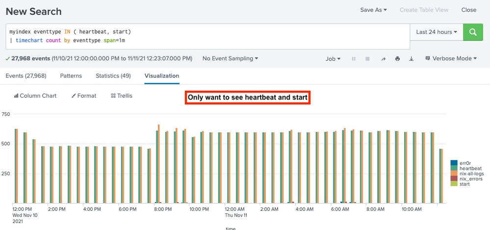

Hello, I am trying to timechart two event types ONLY: heartbeat and start.
However, every event in our Splunk is also mapped as nix-all-logs and few other events by the system admin.
Attached are screenshots.  How can I timechart these 2 event types only.

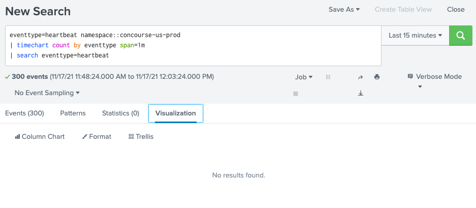

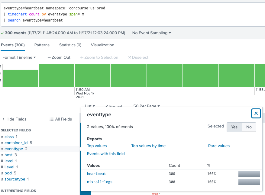

noman377
@PickleRick - unfortunately, not able to make it work.  The eventtype that is present for every log is still showing up in events tab and timechart tab comes out empty. splunk_1.pngsplunk_1.pngsplunk_2.pngsplunk_2.png
PickleRick
Ahhh. Of course. Timechart renders the data as table with eventtypes as columns.
So in order to return only heartbeat eventtype you'd need to not | search but simply
 | table _time heartbeat
