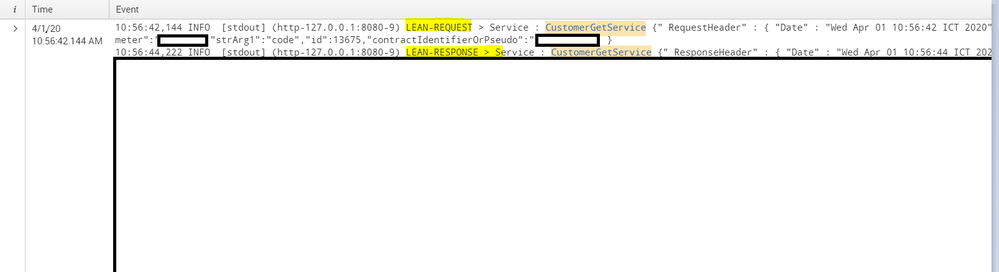

Hello everyone,
I am trying to extract some data from the logs.
I have created a little search that works well:
customergetservice host=MBKBKKSPHTRSP0* source="/var/log/jbossas/standalone/server.log" | transaction RequestId
It links the request and the response from the server by the extracted field RequestId.
However, I am trying to filter only some parameter contained in the field Login:
The login has many possibilities of different values, but it starts with either:
  • "BBC-*"
  • "BBF-*"
  • "BFL-*"
  • "BCIMR-*"
The login is only in the request, and not in the response.
I am trying to filter by putting the following
customergetservice host=MBKBKKSPHTRSP0* source="/var/log/jbossas/standalone/server.log" | transaction RequestId startswith="BCIMR-*"
However, when I add the StartsWith, everything's broken, as the events are not linked together anymore.
See following comment for example as I can't add more than 2 images per question

Thanks to the three of you for your quick input about my problem!
I'm happily surprised of the reactivity on this forum, as this was my very first post...
However, none of the solutions provided did work for me.
@PavelP, although your solution seemed great, I got the same result as attached in previous screenshot. The response and request are not grouped in the same event when adding the startswith ...
@to4kawa and @woodcock , thank you for your suggestions, could you please explain me why transaction is overkill for what I am trying to achieve?
It's the only solution I have found in the Splunk documentation to match two corresponding events in the same splunk result.
It enables me to see what is in each request and what is the associated response.
stats here is not the thing I am trying to achieve just yet.
Thank you

gmasy
New Member
x-axis would be the time
y-axis would be te average response time
We like to monitor the response time over a period, to detect if a component is down.
Please see example below of what I could achieve with transaction. However this method is very long and usually times out if I check on a very long time span.
