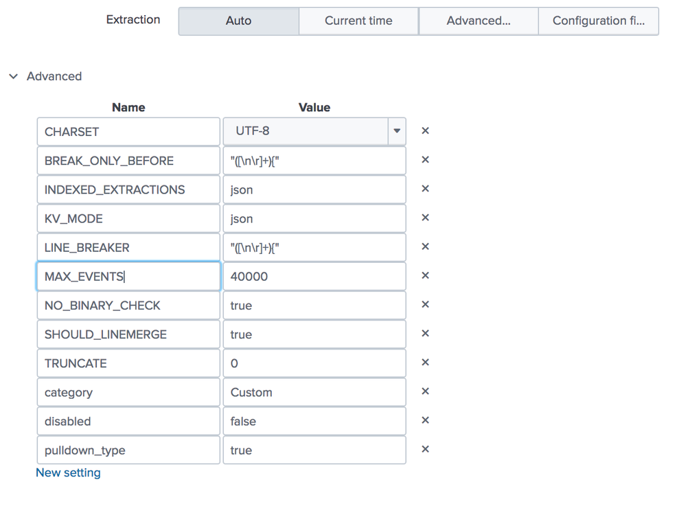

Instead of change the limits.conf, you can change it directly on sourcetype configurations. Search your sourcetype, click on edit and then add in advanced configuration the parameter below:
Name = MAX_EVENTS
Value = 10000
The field value you can change as you go. Attached a picture with a configuration that I have very similar like that.

I have applied MAX_EVENTS 40000 for the the _json  source type, big fields become searchable, but field name was not extracted. I tried to add maxchars. It did not help as well.
Is there any way how to make Splunk Cloud extract big fields (above 20K)?
Name = MAX_EVENTS
Value = 10000

Thank you a lot, that solved it! 😄
