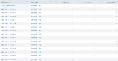

Here is one way of implementing it (assuming that ProcessingTimeMS is the field that represents response time).
This example generates and analyze the last 30 minutes of sample day.
  • Summarizes the last 10 minutes with min, avg, and max response time and populates each event for later filtering.
  • You can adjust the filter based on how strict you want it, for example
    • Every response time within last 10 minutes > 3
      • last_10m_min_secs>3
    • If you want to use average response time:  last_10m_avg_secs>3
The reason to expand the search to say 30 minutes is to provide some historical data for reference. Having additional data will make a standalone alert more meaningful/useful. Of course, this creates some overhead which you need to consider.
| makeresults | eval start=now()-1800, end=now()
| eval range=MVAPPEND(start, end)
| mvexpand range | eval _time=range | fields _time
| makecontinuous _time span=30s | sort 0 -_time
| eval ProcessingTimeMS=(random() % 20000) + 1000
| eval time_secs=ProcessingTimeMS/1000
| bucket _time span=1m | stats avg(time_secs) AS avg_secs max(time_secs) AS max_secs min(time_secs) AS min_secs BY _time
| eval stats_name=strftime(_time, "%Y-%m-%d %H:%M:%S")
| appendpipe [| where _time>relative_time(now(), "-10m@m")      | rename avg_secs AS time_secs
| foreach * [| eval <<FIELD>>=ROUND(<<FIELD>>) | eval last_10m_<<FIELD>>=<<FIELD>>]
| eval stats_name="_Last 10 Min Stats_"]
| eventstats max(last_10m_min_secs) AS last_10m_min_secs max(last_10m_max_secs) AS last_10m_max_secs max(last_10m_avg_secs) AS last_10m_avg_secs
| sort 0 - stats_name
| foreach *secs [| eval <<FIELD>>=ROUND(<<FIELD>>)]
| eval stats_type="RESPONSE TIME"
| table stats_name stats_type avg_secs min_secs max_secs last_10m*
| where last_10m_avg_secs>3
| fields - last_*
