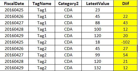

Hello Everybody,
I've a table (w/o the yellow column), as shown below. I want to eval another field (in yellow). It shows the difference between the LatestValue, by Category2, TagName, FiscalDate (number). Pls. advise. Thanks.

htkwan
Hello Javiergn,
It works partially. See below.

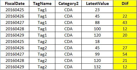

It should be as below.
javiergn
Super Champion
If you don't want the negative numbers then simply append the following to your search:
| eval Diff = if (Diff < 0, "", Diff)
