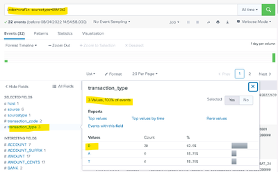

I hope someone can enlighten me with this seemingly simple problem.
I have this very simple search return 32 rows and showing that all events have a transaction_type value.
If I click on the D highlighted above I would expect it to show me just the 20 D rows but instead I get:
Very weird.
If I change the search to
index=orafin sourcetype=ORAFIN2 NOT transaction_type!=D
Then I get what I want:
Can someone please explain what is happening?
Thanks, Keith
