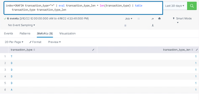

@KeithH
Can you please make sure there is No trailing space in transaction_type fields? Just execute below search and check the transaction_type_len, it should be 1 for value D.
index=orafin sourcetype=ORAFIN2 transaction_type="*"
| eval transaction_type_len = len(transaction_type) | table transaction_type transaction_type_len
Thanks
KV

KeithH
Communicator
Hi Kamlesh,
Thanks for the suggestion.  I ran what you sent but it shows the field values as 1 byte long.
So its not htat.
