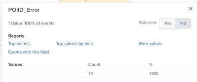

Hi All,
Here is my how my event looks like -
20/11/2023 12:47:05 (01) >> AdyenProxy::AdyenPaymentResponse::ProcessPaymentFailure::Additional response -> Message : NotAllowed ; Refusal Reason : message=MessageHeader.POIID: NotAllowed Value: P400Plus-805598742, Reason: my POIID is P400Plus-805598450
I am trying to extract the part "POIID: NotAllowed Value: P400Plus-805598742, Reason: my POIID is P400Plus-805598450"
I am using this regex -
| rex field=_raw "MessageHeader.+(?<POIID_Error>)-*"
But the field vale POIID_Error seems to be blank after running the query.
Attaching the ss for reference.
Little suggestion to fix this is appreciated.
Labels (3)
ITWhisperer
MessageHeader\.(?<POIID_Error>.+)
man03359
Communicator
@ITWhisperer
it seems to be working now , thanks a lot 🙂 🙂
