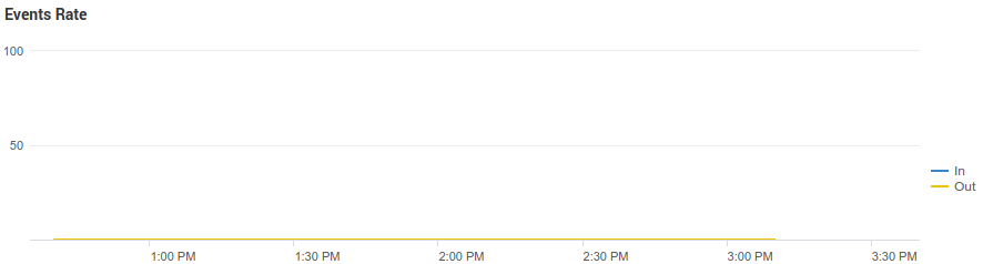

When the dashboard draws initially the chart has a y-axis that just includes the data (currently 7.5). When I select a row in the table the chart redraws with the y-axis up to 100, well over what is required. Selecting back to the original row keeps the y-axis maximum value of 100, which renders the data as a tiny curve at the very bottom of the chart.
Any thoughts? I've left the y-axis max at the default, documented as auto. I think it works right the first time but not afterwards.

@madkins23, the y-axis max by default adjusts based on maximum value to be plotted. So, this seems to be a bug in case your data is nowhere close to 100 and y-axis expands to 100 and you should reach out to Splunk support for assistance.
Can you add screenshot of table and timechart for the first time and after clicking a row as the dummy dashboard on similar line to your example works fine for me?
If you know what your Maximum Y axis label is going to be, you can set the same as token and then use that for configuration of timechart.

madkins23
New Member
Here are the screen shots:
When dashboard initially displays
After switching to another table choice and switching back
I noticed some more things this morning:
  • When I got in there were no events so the graph was all zeros.
  • With nothing but zeros the graph goes from 0 - 100 "by default".
  • The other entry in the table presents a graph which currently is all zeros.
I created some data for the first row in the table to find and got yesterday's behavior back. I haven't been able to create events for the second row.
My current theory is that when I switch from the first row to the second row (where there are no items) the graph goes from showing a reasonable range to showing the "default range" of 0 - 100. Then when I switch back this range is retained.
