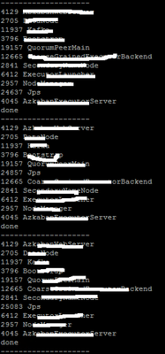

As shown in the below picture, those are the events with a timestamp. I want when a "Kafka" service or "Jps" services are down, I will get an alert. How to write a search query for this when any of the below services are down, I will get an alert.

@gcusello there is no fields to segregate.
Actually, the question is In a Linux machined using JPS command some services is are running, ex: Kafka, JPS etc with PID, if any services are stopped we need to get an alert.
Here some tricky idea I have, so if the keyword "Kafka" is not seen in events for more than 1 minute I want to get that alert, so based on this the application team to know oh! the Kafka services are not running in that particulate host.

bowesmana
I suspect the problem is that, based on your data, that your event contains 1...n of the processes that are present, so event 1 may contain
123 Kafka
345 Bootstrap
567 Jps
and you are trying to see if Jps OR Kafka OR Bootstrap OR other OR other are not present for a minute

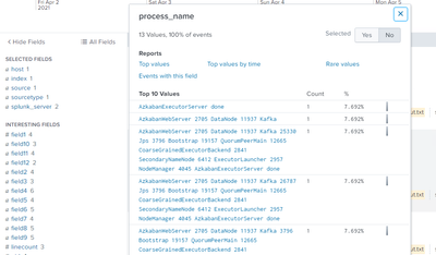

phanichintha
I created CSV like this:
Next created query like this:
The process_names shows like this:
bowesmana
