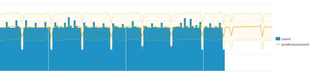

Here's an example of data that's pretty predictable:
easily predicted data
You'll see that it's consistent and there's quite a bit of it. The more data points you have the better your prediction capability, right?

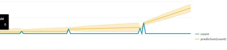

Here's an example of data that's so sparse it's hard to predict.
hard to predict data
There's just so little the "predict" command can't do anything accurate with it. That's similar to having data, but it being so scattered that it's hard to predict.
In general, if you don't have 30+ data points your predictions will be poor. If you have high variation (that doesn't have a nice, easily discerned repeating pattern), your predictions will also be poor. Like the second example.
If instead you have fairly large amount of consistent (or consistently changing) data the predictions can be pretty tight. Like the first example.
