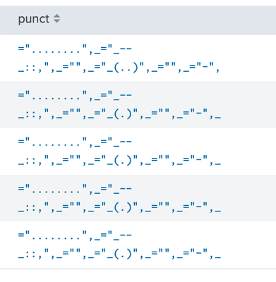

if you are not interested those exact error messages you can use field punct to grouping those.
| stats values(error_msg) as error by punct
Probably it didn't give you a exactly what you are wanting but maybe you can use is as a starting point?
r. Ismo
erica
Hmm Im not sure how punct is used here?
it turns the error into serious of character and im not able to get any result with any grouping command
eg:
| Top 25 punct
Tags (1)
isoutamo
https://docs.splunk.com/Splexicon:Punct
Basically punct shows somekind of pattern of _raw.  This means that it also shows pattern of your error message. If those error messages are enough close to each other then those puncts are same even e.g. words are not exactly same. Maybe as I already said this is not a best option for you case but e.g. classifying errors in _internal it works quite well.
