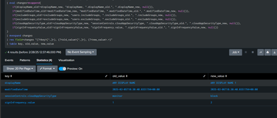

@vikashumble
| makeresults
| eval json1="{\"id\": \"XXXXX\",\"displayName\": \"ANY DISPLAY NAME\",\"createdDateTime\": \"2021-10-05T07:01:58.275401+00:00\",\"modifiedDateTime\": \"2025-02-05T10:30:40.0351794+00:00\",\"state\": \"enabled\",\"conditions\": {\"applications\": {\"includeApplications\": [\"YYYYY\"],\"excludeApplications\": [],\"includeUserActions\": [],\"includeAuthenticationContextClassReferences\": [],\"applicationFilter\": null},\"users\": {\"includeUsers\": [],\"excludeUsers\": [],\"includeGroups\": [\"USERGROUP1\", \"USERGROUP2\"],\"excludeGroups\": [],\"includeRoles\": [],\"excludeRoles\": []},\"userRiskLevels\": [],\"signInRiskLevels\": [],\"clientAppTypes\": [\"all\"],\"servicePrincipalRiskLevels\": []},\"grantControls\": {\"operator\": \"OR\",\"builtInControls\": [\"mfa\"],\"customAuthenticationFactors\": [],\"termsOfUse\": []},\"sessionControls\": {\"cloudAppSecurity\": {\"cloudAppSecurityType\": \"monitor\",\"isEnabled\": true},\"signInFrequency\": {\"value\": 1,\"type\": \"hours\",\"authenticationType\": \"primaryAndSecondaryAuthentication\",\"frequencyInterval\": \"timeBased\",\"isEnabled\": true}}}"
| eval json2="{\"id\": \"XXXXX\",\"displayName\": \"ANY DISPLAY NAME 1\",\"createdDateTime\": \"2021-10-05T07:01:58.275401+00:00\",\"modifiedDateTime\": \"2025-02-06T10:30:40.0351794+00:00\",\"state\": \"enabled\",\"conditions\": {\"applications\": {\"includeApplications\": [\"YYYYY\"],\"excludeApplications\": [],\"includeUserActions\": [],\"includeAuthenticationContextClassReferences\": [],\"applicationFilter\": null},\"users\": {\"includeUsers\": [],\"excludeUsers\": [],\"includeGroups\": [\"USERGROUP1\", \"USERGROUP2\", \"USERGROUP3\"],\"excludeGroups\": [\"USERGROUP4\"],\"includeRoles\": [],\"excludeRoles\": []},\"userRiskLevels\": [],\"signInRiskLevels\": [],\"clientAppTypes\": [\"all\"],\"servicePrincipalRiskLevels\": []},\"grantControls\": {\"operator\": \"OR\",\"builtInControls\": [\"mfa\"],\"customAuthenticationFactors\": [],\"termsOfUse\": []},\"sessionControls\": {\"cloudAppSecurity\": {\"cloudAppSecurityType\": \"block\",\"isEnabled\": true},\"signInFrequency\": {\"value\": 2,\"type\": \"hours\",\"authenticationType\": \"primaryAndSecondaryAuthentication\",\"frequencyInterval\": \"timeBased\",\"isEnabled\": true}}}"
| spath input=json1 path="displayName" output=displayName_old
| spath input=json2 path="displayName" output=displayName_new
| spath input=json1 path="modifiedDateTime" output=modifiedDateTime_old
| spath input=json2 path="modifiedDateTime" output=modifiedDateTime_new
| spath input=json1 path="conditions.users.includeGroups{}" output=includeGroups_old
| spath input=json2 path="conditions.users.includeGroups{}" output=includeGroups_new
| spath input=json1 path="conditions.users.excludeGroups{}" output=excludeGroups_old
| spath input=json2 path="conditions.users.excludeGroups{}" output=excludeGroups_new
| spath input=json1 path="sessionControls.cloudAppSecurity.cloudAppSecurityType" output=cloudAppSecurityType_old
| spath input=json2 path="sessionControls.cloudAppSecurity.cloudAppSecurityType" output=cloudAppSecurityType_new
| spath input=json1 path="sessionControls.signInFrequency.value" output=signInFrequencyValue_old
| spath input=json2 path="sessionControls.signInFrequency.value" output=signInFrequencyValue_new
| eval changes=mvappend(
if(displayName_old!=displayName_new, "displayName, ".displayName_old.", ".displayName_new, null()),
if(modifiedDateTime_old!=modifiedDateTime_new, "modifiedDateTime, ".modifiedDateTime_old.", ".modifiedDateTime_new, null()),
if(includeGroups_old!=includeGroups_new, "users.includeGroups, ".includeGroups_old.", ".includeGroups_new, null()),
if(excludeGroups_old!=excludeGroups_new, "users.excludeGroups, ".excludeGroups_old.", ".excludeGroups_new, null()),
if(cloudAppSecurityType_old!=cloudAppSecurityType_new, "sessionControls.cloudAppSecurityType, ".cloudAppSecurityType_old.", ".cloudAppSecurityType_new, null()),
if(signInFrequencyValue_old!=signInFrequencyValue_new, "signInFrequency.value, ".signInFrequencyValue_old.", ".signInFrequencyValue_new, null())
| mvexpand changes
| rex field=changes "(?<key>[^,]+), (?<old_value>[^,]+), (?<new_value>.+)"
| table key, old_value, new_value
Did this help? If yes, please consider giving kudos, marking it as the solution, or commenting for clarification — your feedback keeps the community going!

Hello @kiran_panchavat
This does work if I the changed values are only in the fields I deleberatley changed values from. In other words, displayName, modifiedDateTime etc. BUt what I am looking for is if values are changed in any of this json object (say some events have changed values in id or something else). I think that would not be captured by your query (I have tested that). Hence I cannot accept this as a solution as of now
