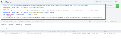

My Sample Search :
| makeresults | eval raw="TS=06/22/2021 08:50:39:390|Type=A|Ids=550&&TS=06/22/2021 08:51:39:390|Type=B|Ids=495,550,698" | eval raw=split(raw,"&&")
| mvexpand raw | rename raw as _raw | extract pairdelim="|" kvdelim="="
| search Type="A"
| join Type Ids [| makeresults | eval raw="TS=06/22/2021 08:50:39:390|Type=A|Ids=550&&TS=06/22/2021 08:51:39:390|Type=B|Ids=495,550,698" | eval raw=split(raw,"&&")
| mvexpand raw | rename raw as _raw | extract pairdelim="|" kvdelim="=" | search Type="B"
| eval Ids=split(Ids,",") | eval Type="A" | rename TS as TS1
| mvexpand Ids]
| eval "Time Passed (In Sec)"= round(strptime(TS1,"%m/%d/%Y %H:%M:%S.%3N") - strptime(TS,"%m/%d/%Y %H:%M:%S.%3N")),"Time Passed"=tostring('Run Time (In Sec)',"duration")
