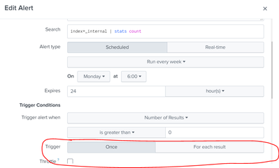

you can use filed= value1 OR filed=value2 and so on in the search. You can always configure the alert to send an email for each result OR group of results.
