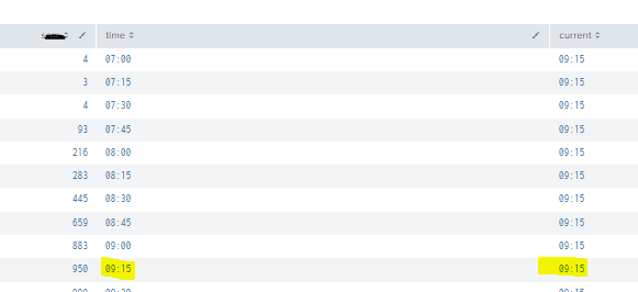

but when I compare the current time with the past time (see my where clause) it displays nothing
`index` sourcetype="session"  earliest=-7d@d+7h latest=-7d@d+19h
| bin _time span=15m
| eval time=strftime(_time,"%H:%M")
| stats dc(s) as s by time
| eval current=now()+(15*30)-1
| bin current span=15m
| fieldformat current=strftime(current,"%H:%M")
| where time=current
| table s time current
 it's strange because I can see data on the same slot time
ITWhisperer
fieldformat doesn't change the value of the field, it just changes the way the field is display. Change it to
| eval current=strftime(current,"%H:%M")
jip31
Motivator
perfect ITWhisperer, thanks
