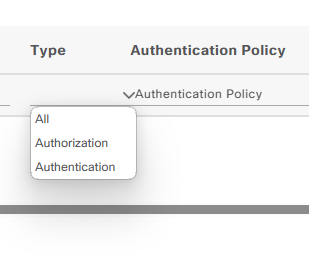

In Cisco ISE TACACs live logs I do have the option for filtering both:
Authorization
Authentication.
However, in splunk I also tried to filer for Authorization and Authentication, but only was able to filter for type Accountings.
