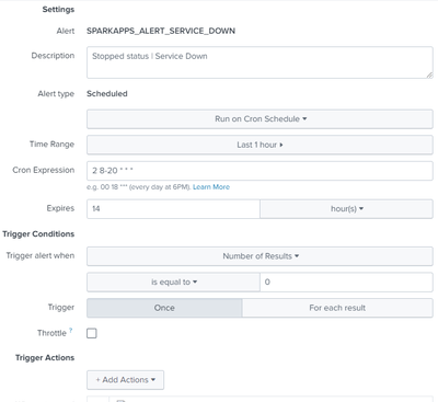

Is this right .I did this:
Tags (2)
jakeoftrades
I think I should have change the number of results which  is = 3 instead of 0 by the condition that it will only send alert.. it has been sending alert even without result.
VatsalJagani
yes, that looks alright.
jakeoftrades
Thank you @VatsalJagani  I appreciate it !
