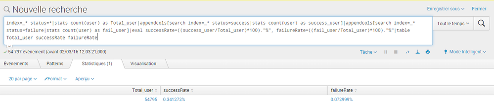

Hi
This will help
index=_* status=*|stats count(user) as Total_user|appendcols[search index=_* status=success|stats count(user) as success_user]|appendcols[search index=_* status=failure|stats count(user) as fail_user]|eval successRate=((success_user/Total_user)*100)."%", failureRate=((fail_user/Total_user)*100)."%"|table Total_user successRate failureRate
Look at the result
chimell
Motivator
Good Thanks
