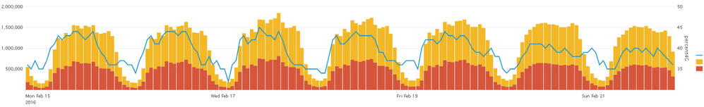

Can I control which y-axis is on the left and which is on the right?
HattrickNZ
Motivator
for instance in the below can i have percent on the left and the 2million axis on the right? Does it have to do with the order of the columns/fields from the search?

The overlay variable goes on the right and the other on the left. Don't think this has to do with the order of the calculations in the search. See this
http://docs.splunk.com/Documentation/Splunk/6.1/Viz/Chartcontrols#Chart_overlay_example_.28dual_axis...

tks but can I swap this and have the overlay use the left y axis and the stacked bar chart use the right y axis?

it seems what ever I chart overlay(in the pic above it is percent4G) goes to the axis on the right, but how do i decide which axis it is on?
