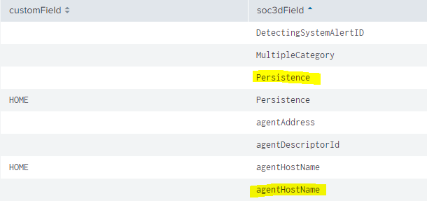

$multi$ - could contain multiple values that I get from multiselect
The table I get is with duplicate rows:
What I'm trying to do is to take all the values in the $multi$ (contain the soc3dField) ---> update the customField in the lookup

@hketer in order to set the tokens from multiselect input you would need to use
1) Either an independent search to set the required tokens using SPL as per requirement.
2) Simple XML JS extension to handle multiselect change and set the required tokens using SplunkJS
PS: Refer to one of my older answer for details on both approach: https://answers.splunk.com/answers/681099/multiselect-option-not-getting-displayed-if-the-op.html
For your use-case following is a run anywhere example with Simple XML dashboard with independent search to set the two required tokens i.e.
1. $tokSoc3Fields$: "bytesIn,bytesOut"
2. $tokSoc3FieldsNotEqual$: soc3dField!="bytesIn" AND soc3dField!="bytesOut"
You can use the above tokens in your final SPL which works for you with static code.
