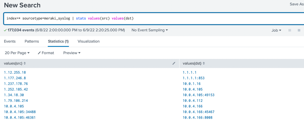

@PickleRick, I wasn't sure what to replace index=<your_index> with so I left index* 😐 but this is a sample output:

PickleRick
Your data is in some index, so you should put the name of this index (I assume you're not ingesting it into multiple indexes).
Now you have a summary, you can see what values are there in your src and dst fields and if you get this range of yours at all.

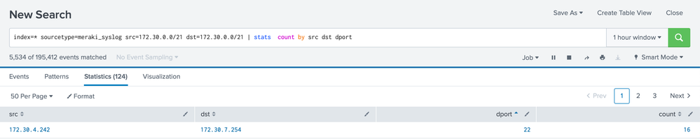

index=<your_index> sourcetype=meraki_syslog src=172.30.0.0/21 dst=172.30.0.0/21
| stats count by src dst dport

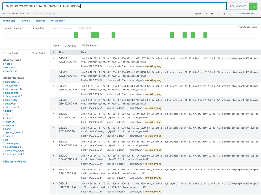

@PickleRickthanks for all the help so far, it definitely looks I'm not getting data to pull in 100% correctly. When I did NMAP for the entire subnet from my Kali box (172.30.4.244) it's only being represented as two scans each time, even though I'm scanning the entire /21 subnet for port 22, and it's showing the destination port as 254.
