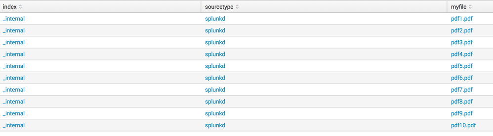

I guess you could use map. For instance, take a look at the following example:
| stats count
| eval n = mvrange(1,11)
| mvexpand n
| eval file_in = "pdf" + n + ".pdf"
| eval file_out = "pdf" + n + ".csv"
| fields - n, count
| map search="search index=_internal earliest=-1h | head 1 | table index, sourcetype | eval myfile=$file_in$"
Output (see picture)
