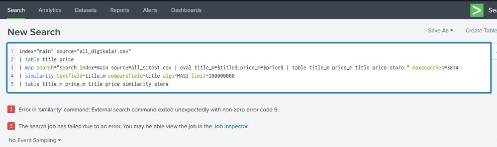

I use nlp-text-analytics app for similarity between two strings but I get above error

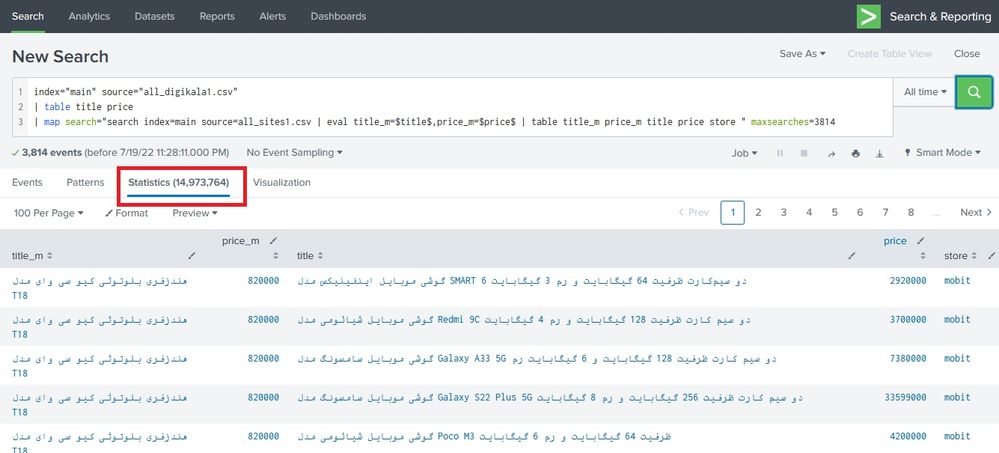

when I run lines 1, 2, and 3, it gives a result of about 14,973,764 (3814*3926)

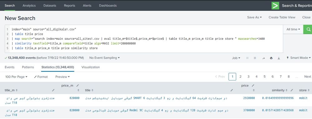

It is interesting that if I reduce the data, for example, the output of the third line is  13.348.400 (3400* 3926 )  , it does not give an error and the result of the fourth line is returned.
This means that the similarity command has problems with data above 13.5 million
my splunk is 8.2
nlp-text-analytics 1.1.3
python_upgrade_readiness_app  4.0.2
