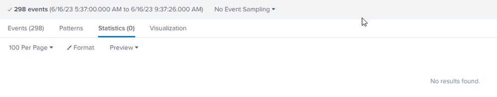

Sureshp191
@yeahnah
Thanks for the solution, even though I see 290 plus events but zero statics.Snag_1302f50a.pngSnag_1302f50a.png
Only when I give as below, I get 250 plus statics but with comma
| rex "PortfolioSymbol: (?<PortfolioSymbol>[^\"]*) Records: (?<Records>[^\"]*) Elapsed: (?<Elapsed>[^\"]*)"
