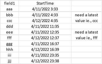

Hello,
I'm trying to  pull the latest values for every 4 hours in a day ie., latest values between the time
00:00:00 to 04:00:00, 04:00:00 to 08:00:00, 08:00:00 to 12:00:000, 12:00:00 to 16:00:00.... Below is the example of how the data looks like. TIA
