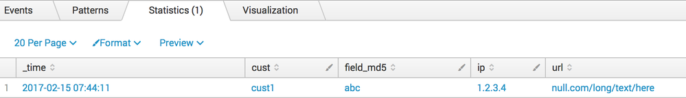

You've got the real data to test with, but for this example, you could fake it with:
| makeresults
| eval field_md5="abc", ip="1.2.3.4", cust="cust1", url="null.com/long/text/here"
To get:
Then add the join to the search:
| makeresults
| join type=inner field_md5
    [| inputlookup lookup-text]
To get:
I'd be really interested to know if that improved things for you. I'll be honest, I haven't worked with a lookup table that size.
