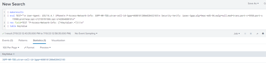

Hello @Tao_Zeng,
You could try something like this
| makeresults
| eval TEST="\n User-Agent: iOS/16.4.1 iPhone\n P-Access-Network-Info: 3GPP-NR-TDD;utran-cell-id-3gpp=4600101200e020432103\n Security-Verify: ipsec-3gpp;alg=hmac-md5-96;ealg=null;mod=trans;port-c=9950;port-s=9900;prot=esp;spi-c=2155781586;spi-s=4286488018\n"
| rex field=TEST "P-Access-Network-Info: (?<KeyValue>.+?)\\\n"
| table KeyValue
GaetanVP_0-1688986725897.pngThanks @yeahnah for the triple backslash, I didn't know it. I thought one "/" to exclude the "/" afterwards would be enough, and n is a literal character so I do not really understand... But it's working !
