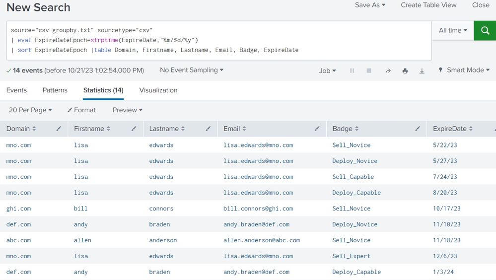

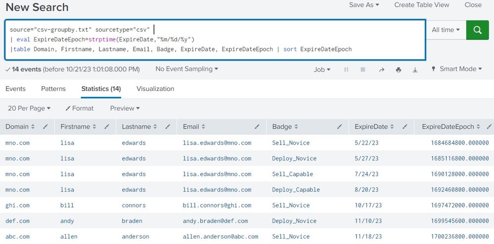

inventsekar
Hi @oneemailall .. I created sample logs as a CSV file, uploaded it to Splunk, created a new field ExpireDataEpoch, sorted the sample logs using the new field ExpireDataEpoch, created the report.
i hope, you can adjust the SPL and fine-tune your requirements.
As you are a new member, let me suggest you, Karma points appreciated, thanks.
Verifying Epoch conversion:
source="csv-groupby.txt" sourcetype="csv"
| eval ExpireDateEpoch=strptime(ExpireDate,"%m/%d/%y")
|table Domain, Firstname, Lastname, Email, Badge, ExpireDate, ExpireDateEpoch | sort ExpireDateEpoch
ExpireDate Sorted Report:
| sort ExpireDateEpoch |table Domain, Firstname, Lastname, Email, Badge, ExpireDate

Assuming that the data set has already been filtered to produce a list of badges with the latest expiration date, what type of search can look at the badge type (per person), and filter to the highest level badge (per badge type) and return only that data?
For example, let's take "Person A". For the Sell type badge, the highest level is Sell_Expert. If "Person A" has earned "Sell_Expert", then only "Sell_Expert" (with the latest expiration date), will show up in the report for the Sell type badge.
If "Person A" has not earned Sell_Expert yet, then the highest level for "Person A" is Sell_Capable.
If "Person A" has not earned Sell_Capable yet, then the highest level for "Person A" is Sell_Novice.
If "Person A" has not earned any Sell type badge yet, they will not have a Sell badge type listed in the final report.
It will be the same logic for Deploy type badge.
