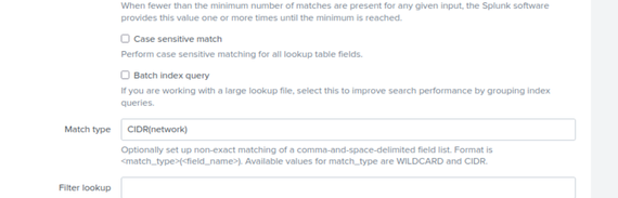

Yes, you need to make a lookup DEFINITION based on the lookup file. In the advanced options for the definition add CIDR(ip_range)
In your SPL you do
index=main
| lookup definition_name ip_range as ip OUTPUT ip_range as found
then you will have the found field as your range if the IP is found or null if not found

As @bowesmana said you need to use a lookup definition instead of querying the lookup file itself. You can refer to this example: https://docs.splunk.com/Documentation/Splunk/9.2.2/Knowledge/Addfieldmatchingrulestoyourlookupconfig....
bowesmana
Your lookup command is looking up file.csv, which is NOT the definition.
The lookup file contains the data, the lookup definition is the lens through which you interpret the data in the file.
alberto-sirt
Thanks very much. It is solve now.
