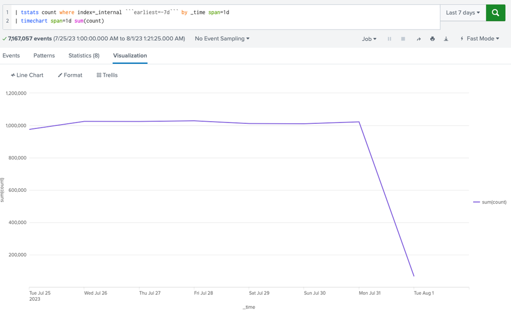

3. Do not use earliest with tstats; use time selector in search screen.
| tstats count where index=_internal ```earliest=-7d``` by _time span=1d
| timechart span=1d sum(count)
I have specific reasons to set earliest with specific token in dashboard.  So, search time selector is not an option.

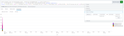

Where future isn't specified, I can at least see it (reluctantly, but with previous data (with start time and end times specified in the time selector), I can't explain it. Example below:
As you can see, I have specified an hour 1 week ago, but for some reason, the timechart insists that latest=now... it's a bug, I'm pretty sure.
