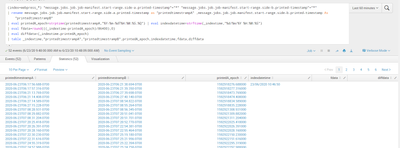

i tried the below query to find the result.
(index=*) "jobs.job.job-manifest.start-range.side-a.printed-timestamp"="*" "jobs.job.job-manifest.start-range.side-b.printed-timestamp"="*"
| rename jobs.job.job-manifest.start-range.side-a.printed-timestamp as "printedtimestrampA" ,jobs.job.job-manifest.start-range.side-b.printed-timestamp As "printedtimestrampB"
| eval printedA_epoch=strptime(printedtimestrampA,"%Y-%m-%dT%H:%M:%S.%Q"),printedB_epoch=strptime(printedtimestrampB,"%Y-%m-%dT%H:%M:%S.%Q")
| eval indextime =_indextime
| eval diffA=indextime-printedA_epoch, diffB=indextime-printedB_epoch
| eval daysA= round((diffA/86400),0) , daysB= round((diffB/86400),0)
|eval  diff=(printedtimestrampB-printedtimestrampA)
| table host as customer,printedA_epoch,printedB_epoch,indextime,diffA,diffB,daysA,daysB,diff
below is the screen shot for reference,
even i tried using rex but could get proper result.
gcusello
Hi @karunagaraprabh ,
as I said, if you have a multivalue field, you cannot do calculations, so you have to define if you want to take for calculation one of the epochtimes (e.g. the first one) or split your event in as many events as the number of values in printedA_epoch.
In the first case use something like my above hint:
your_search
| rename ...
| rex field=printedA_epoch "^(?<printedA_epoch>\d+)"
| eval indextime=_indextime
| eval fdata=round(((indextime-printedA_epoch)/86400),0)
| eval diffdata=indextime-printedA_epoch
| table indextime ...
in the second case, try something like this:
your_search
| spath
| rename jobs.job.job-manifest.end-range.side-a.printed-timestamp AS printedA_timestamp
| eval printedA_epoch=strptime(printedA_timestamp,"%Y-%m-%dT%H:%M:%S.%3N-%z")
| mvexpand printedA_epoch
| table indextime printedA_epoch fdata diffdata
Ciao.
Giuseppe
